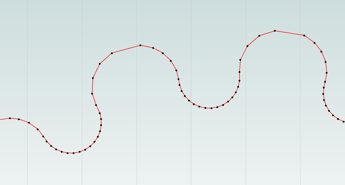

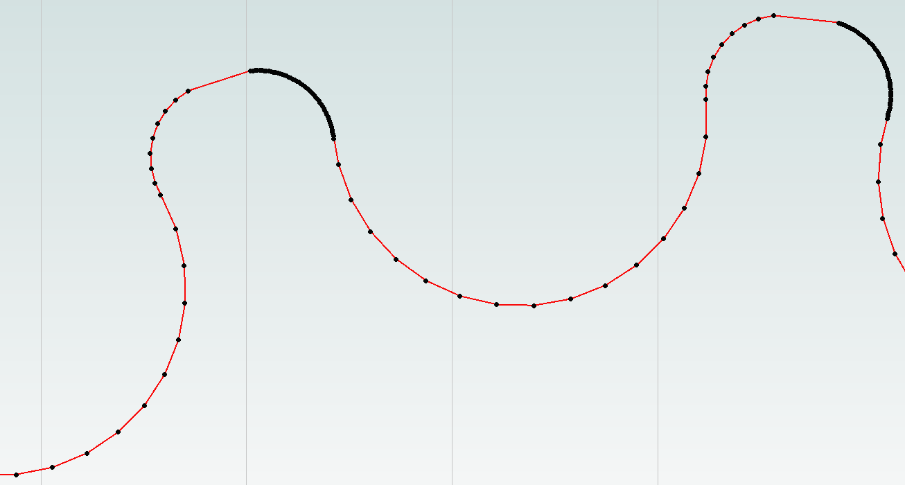

I'm trying to generate some timing pulleys to export as DXF.
The pulley is HTD3m, 15 tooth, units mm.
If I use the default "gear point dist" setting of 0.1, I get an output that isn't precise enough, as shown in the first attachment.
If I set the "gear point dist" to 0.01, I get a very uneven result, which cripples alibre design, as shown in the second attachment.
[Edit: Note the first image is the comped version, but the non-comped is the same]
