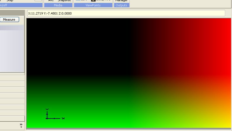

I've had the continuing problem with the background being unchangeable and lending the program unusable. A screen shot of the problem is attached. I've tried changing the colors in settings, but nothing happens.
System is Gearotica 4.82 under XP running under VMWare Fusion on a Macbook. It used to work fine a number of versions ago (don't know for sure when it messed up).
Thanks.

Are these primary colours displayed only on the projects page, or on the gear selection pages as well?

They are on all pages, although on gear selection pages, they seem to be a bit paler or muted.

  Ive gone back to June of last year and I cant see any change in the way the opengl viewer does its screen background draws.
Do you know how long ago the version that worked for you was? Is it possible youve changed soemthing in your openGL system?
(Im not quite sure how VMware does the translations..)
Re: Screen background issue
Oh, by the way, if you set the screen colors in the setup menu all to zero, does the screen change?

If I change to all zeros, I see no change to the screen. If fact changing those values doesn't seem to have any effect at all.
Is there an OpenGL version I should be looking for or even how do I determine which version is running?

  I think its 4.3 as the current version, but there are differing numbering schemes for OpenGL, 1.3 is also common
reference number.
