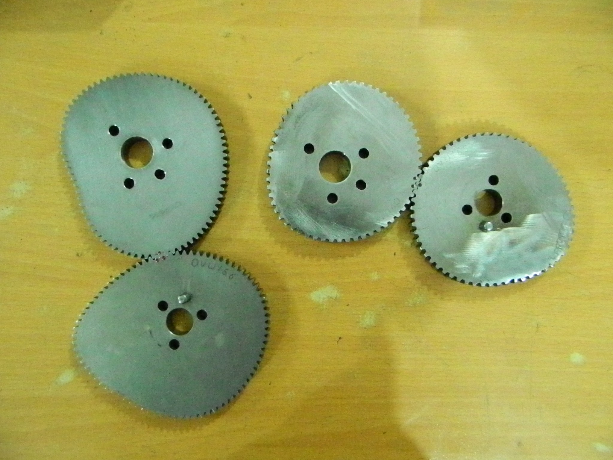

Hi all,
I am visiting this forum after a long time. Need some help and advise. A customer brought these gears to me for cutting on wire edm. We don't have any drawings and just the gears to get the dimensions from. This is the first time I am cutting non circular gears on my wire edm. I need dxf data for the gears' 2D profile. Can gearotic draw these gears, if not then how do you suggest I design it.

Thanks a lot for the help. I've already tried demo version of gearotic. I can recreate the shape of one of the gears with it. But the problem here is that the mating gears are of different shapes (their number of teeth are same). I can recreate the pitch curves of both the gears by rolling a master gear around them and recording it's displacement. Looking for a software to load the pitch curve and generate the tooth form from it. Any suggestions?

It can be observed in the attached pic too. The gear pair on the left is the one I am talking about. When I roll both the gears together, the center distance is 110 mm all around. I am planning to create the pitch curve for the second gear by rolling it around the first one with the center distance. The tooth profile can be drawn in a CAD software by rolling a circular gear of same module on the pitch curve. But that would be a very tedious operation. I would have to draw gear profiles for all the 80 teeth manually. That's why I am looking for some automated software to do it.

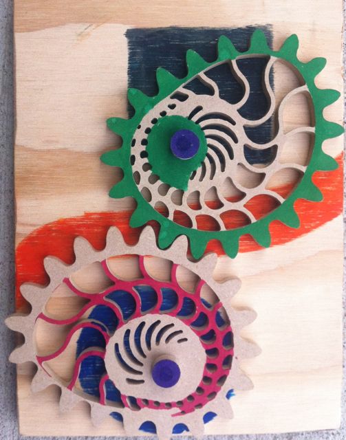

This set was created from the GTA tab. The pinion is 100% controlled by the gear and although they look like they are the same they aren't but they do mesh just fine.
