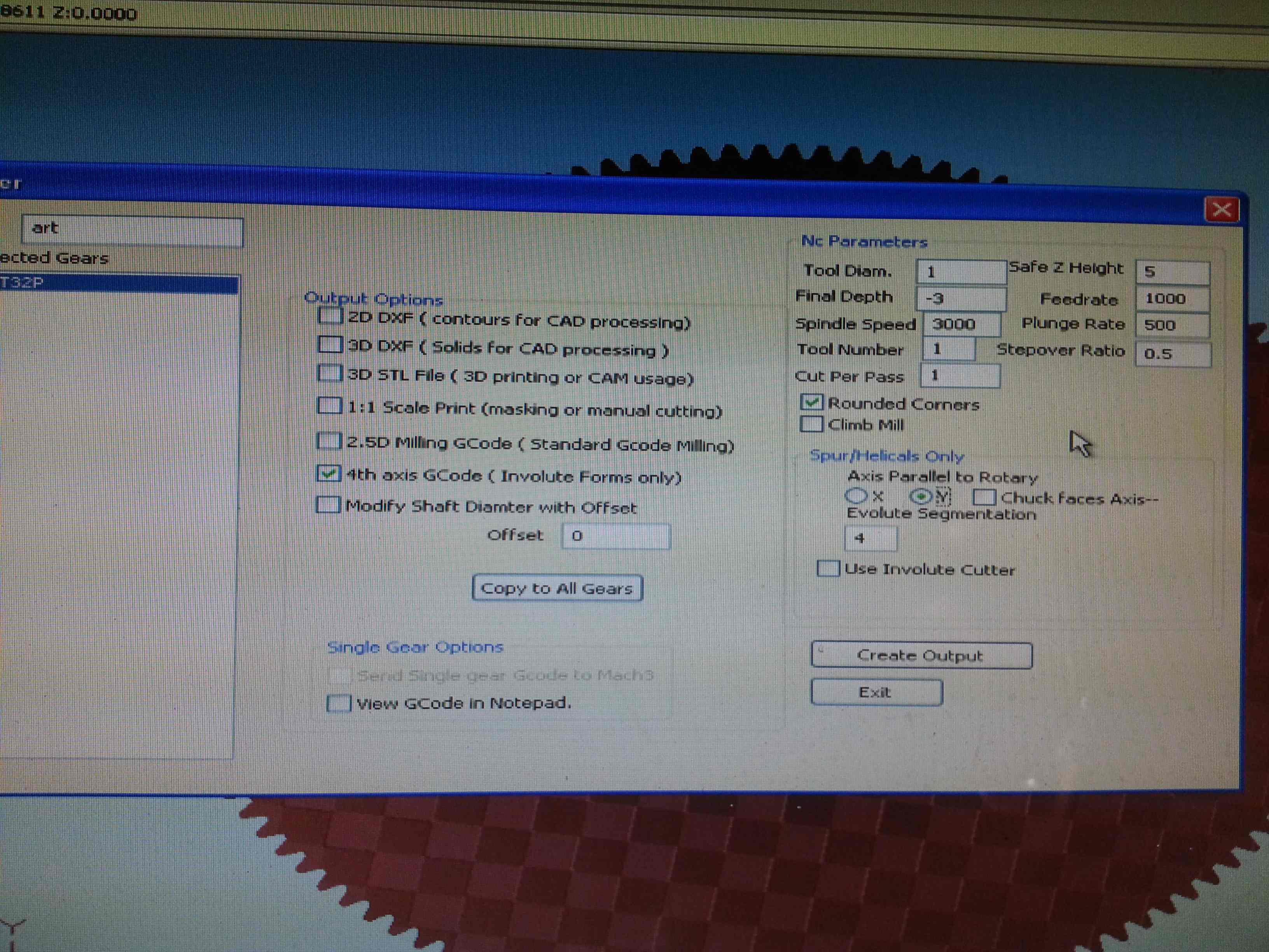

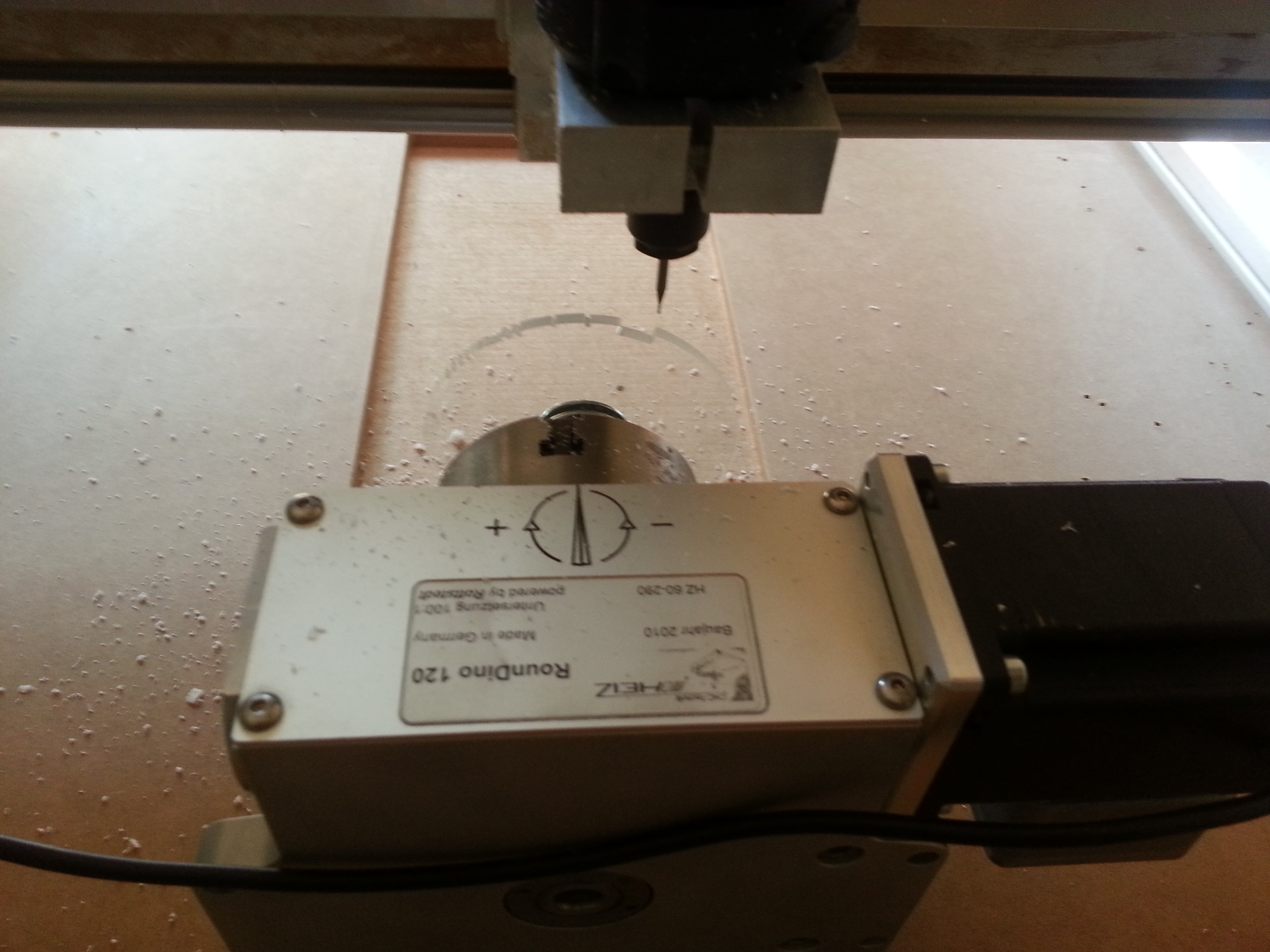

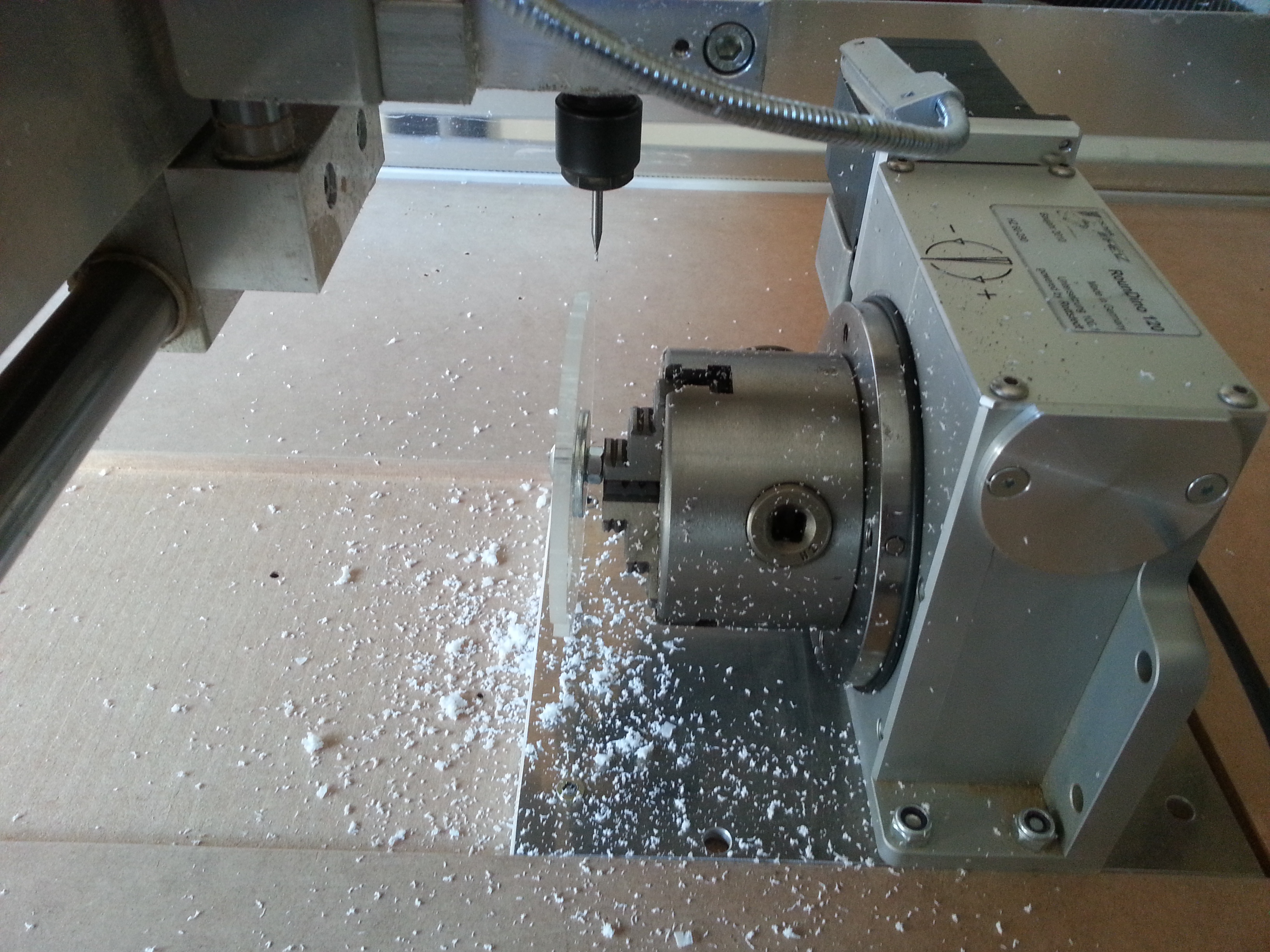

Hi all,
I'm really new at CNC and gears, so please be kind! I used Gearotic to generate a wheel, 32P, 124T, now translating that to metric, I get the module as 0.793 something, the wheel diameter works out to be just over 100mm, if I set the Use Involute Cutter in the Output Manager and tick 4th axis GCode with a 1mm end mill, I get a cut that makes sense to me, a round wheel with 124 straight cuts, I guess I would need a special cutter that is the same as the tooth profile? However, my understanding is that I can cut this profile with a normal end mill? If I do not choose the Use Involute Cutter in the Output Manger, the machine start cutting the gear, but then moves the Y and A axis and eventually ends up to the left of the A axis just cutting air.... My setup is as follow,
X+
Y+ <> Y-
A facing the gantry
X-
With this setup, I guess the Axis Parallel to Rotary, the Y needs to be ticked and the Chuck faces Axis box in Output manager need to ticked? Sorry for all the questions, but I need to understand this.
Thanks for the help!

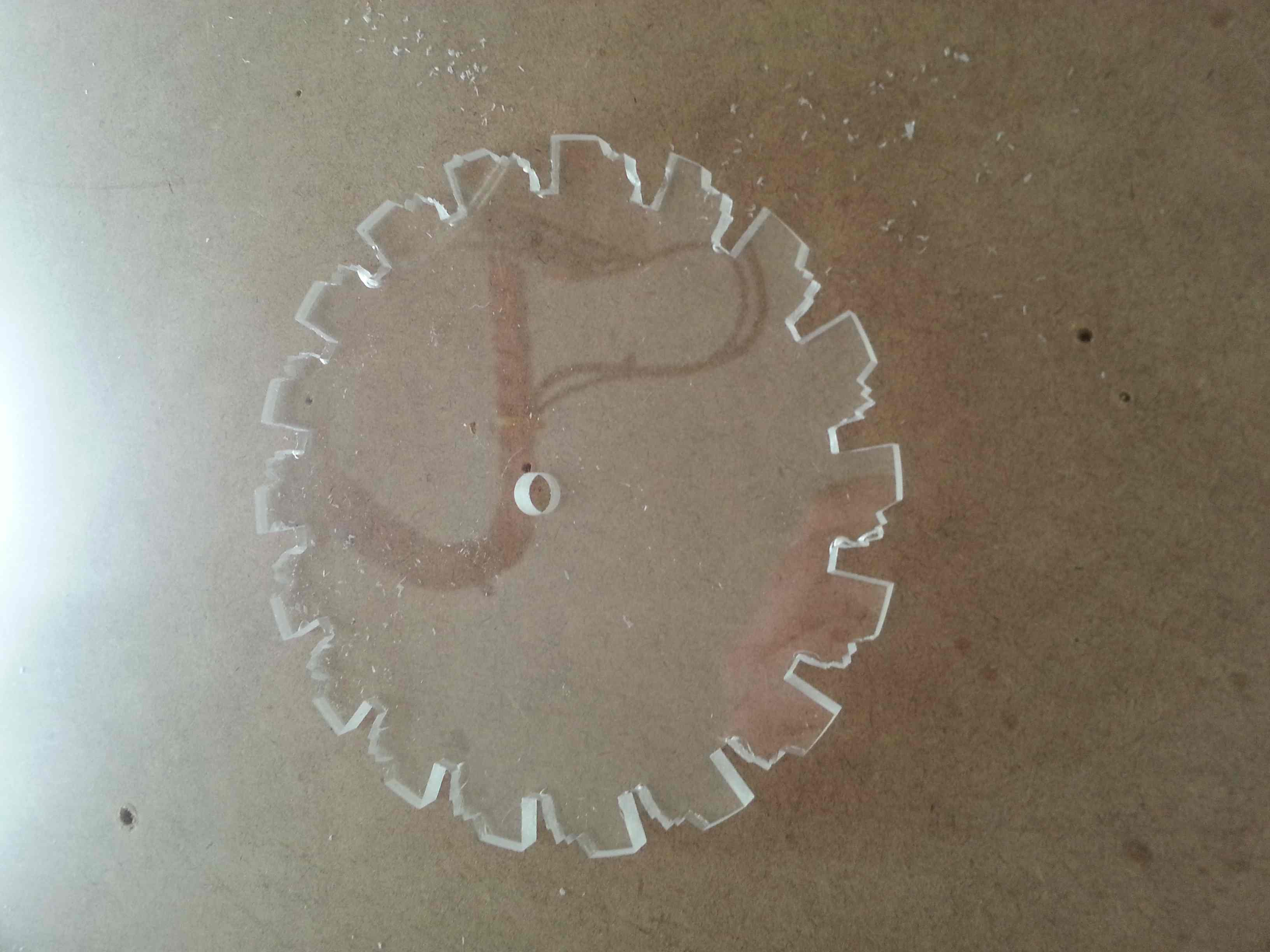

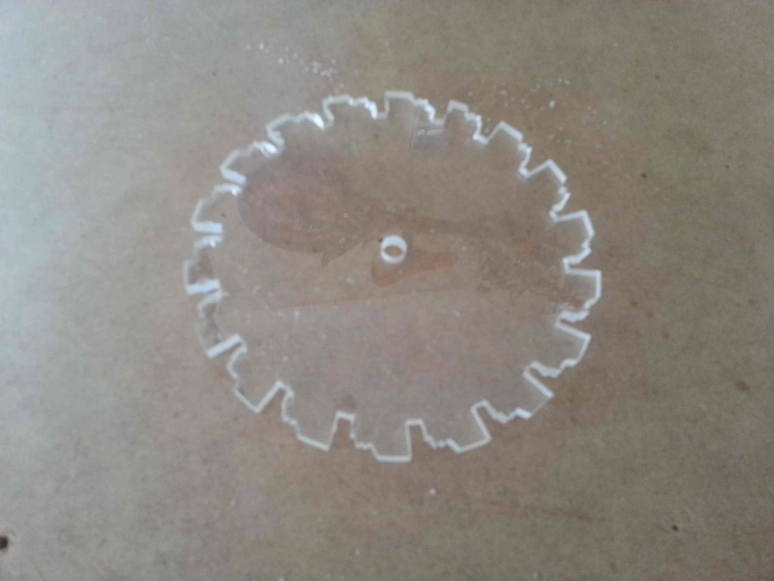

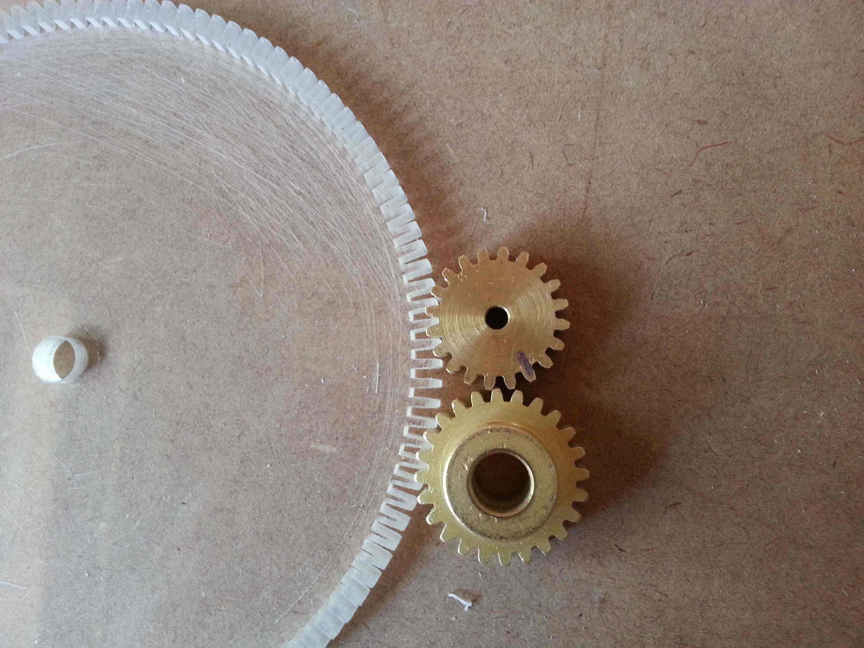

Thanks so much for the explanation, it does make sense (I think) attached are some photos to explain my setup
I will definitely try this over the weekend and let you know if it worked for me, as far as the zeroing is concerned, I take it I place the bit on top of the blank at 0 deg on the A-axis and then move it just past the blank on the X axis in negative and then zero my X-Y-Z-A settings?

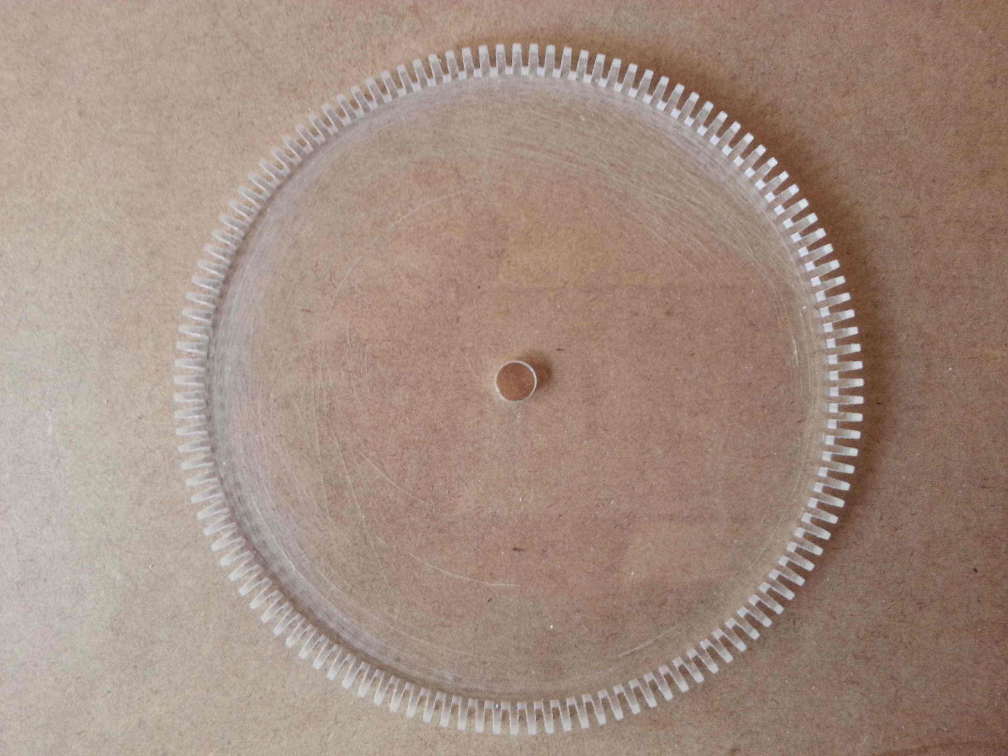

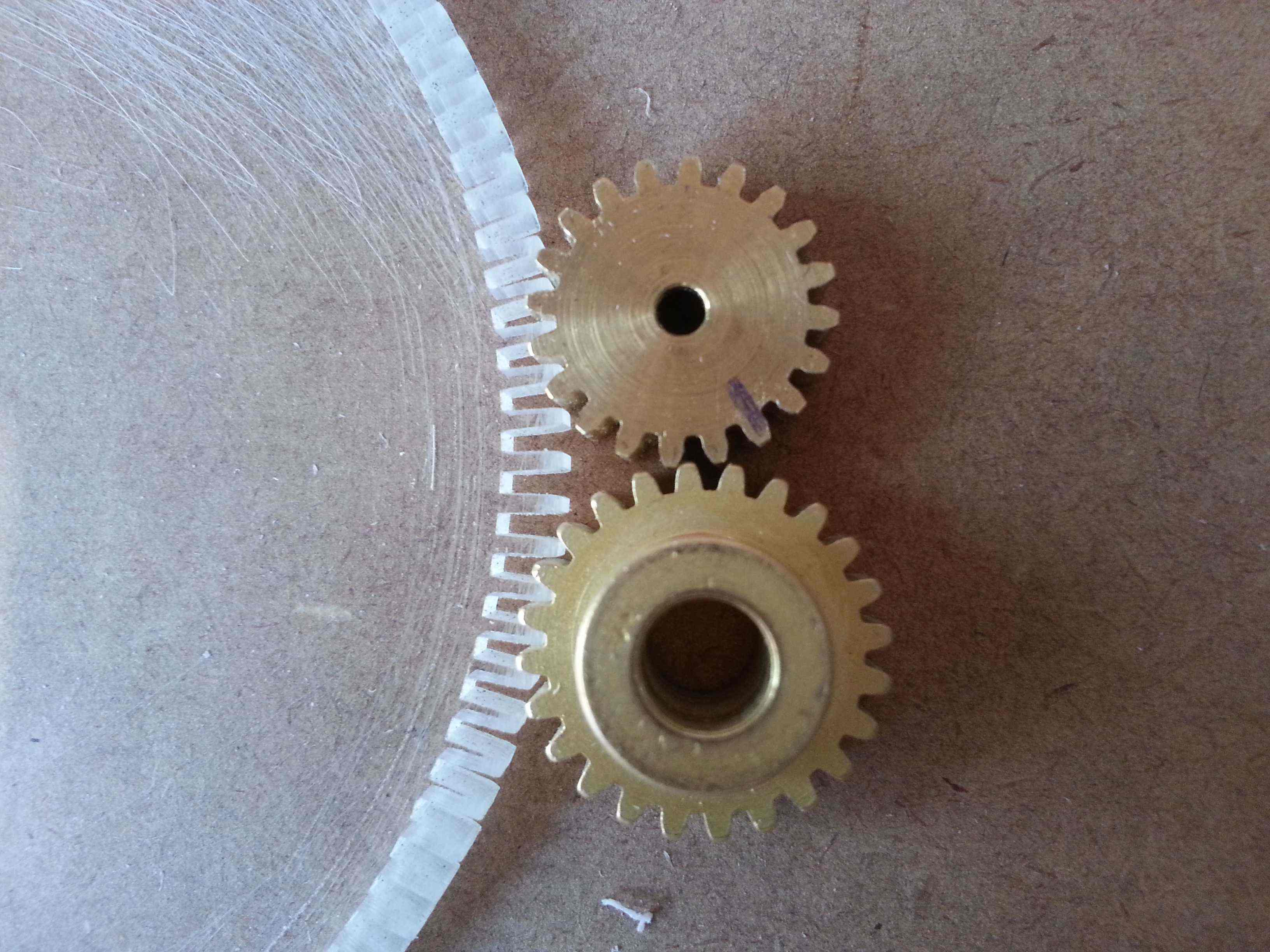

I tried this again, but there is a lot of time spend just cutting air, I tried reversing the A axis, but that did not help either, I also had to set the "Axis Parallel to Rotary" as Y, I'm a bit confused with this setting, let me do a drawing again
X+
Y+ < Gantry > Y-
Spindle
Blank
<A- A+>
X-
The gear was cut, took about 2 hours, meshing seems to be ok, but the teeth depth seems to be a lot, changing that Final Depth does not seem to make a difference. I'll try to upload a video to illustrate the air cutting...

I've uploaded the video to http://youtu.be/QaW5jkDZGoY , maybe that would help to illustrate the air cutting ???

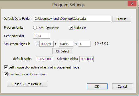

As far as I know, everything was set to mm, in the screenshot of the output manager the diameter of the tool was set to 1mm

It looks like it is trying to cut with the side of a tool that is an inch wide, not a mm wide.
In the Output Manager, in the NC Parameters box, in the Tool Diameter field, try dividing that number by 25.4 (mm/in).
There is another, proper place where this should be corrected, but it slips my mind (I'm only out of bed for a "business trip").

Hi,
Strange but my settings are set to metric, but I will try the INCH to MM over the weekend for the tool diameter
