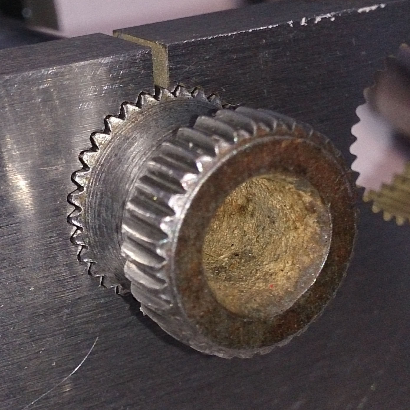

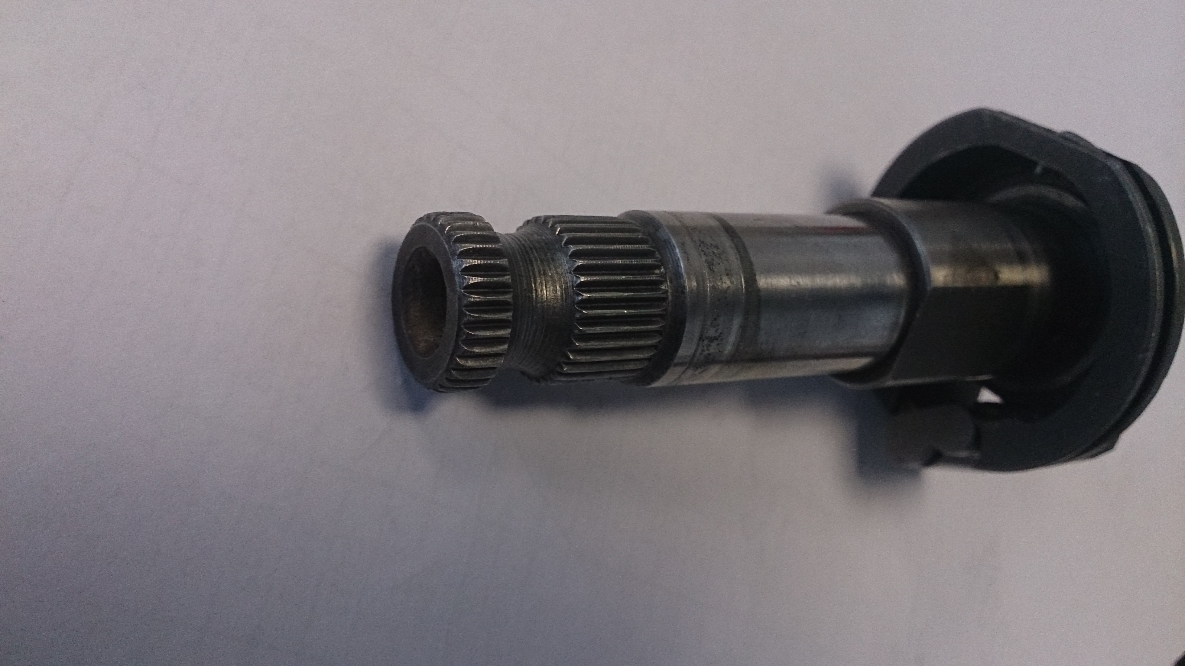

I am trying to make a knuckle to fit on this splined shaft. It is the kickstart shaft on a Honda CR250 motocross bike so it could well be a bespoke Honda spline.

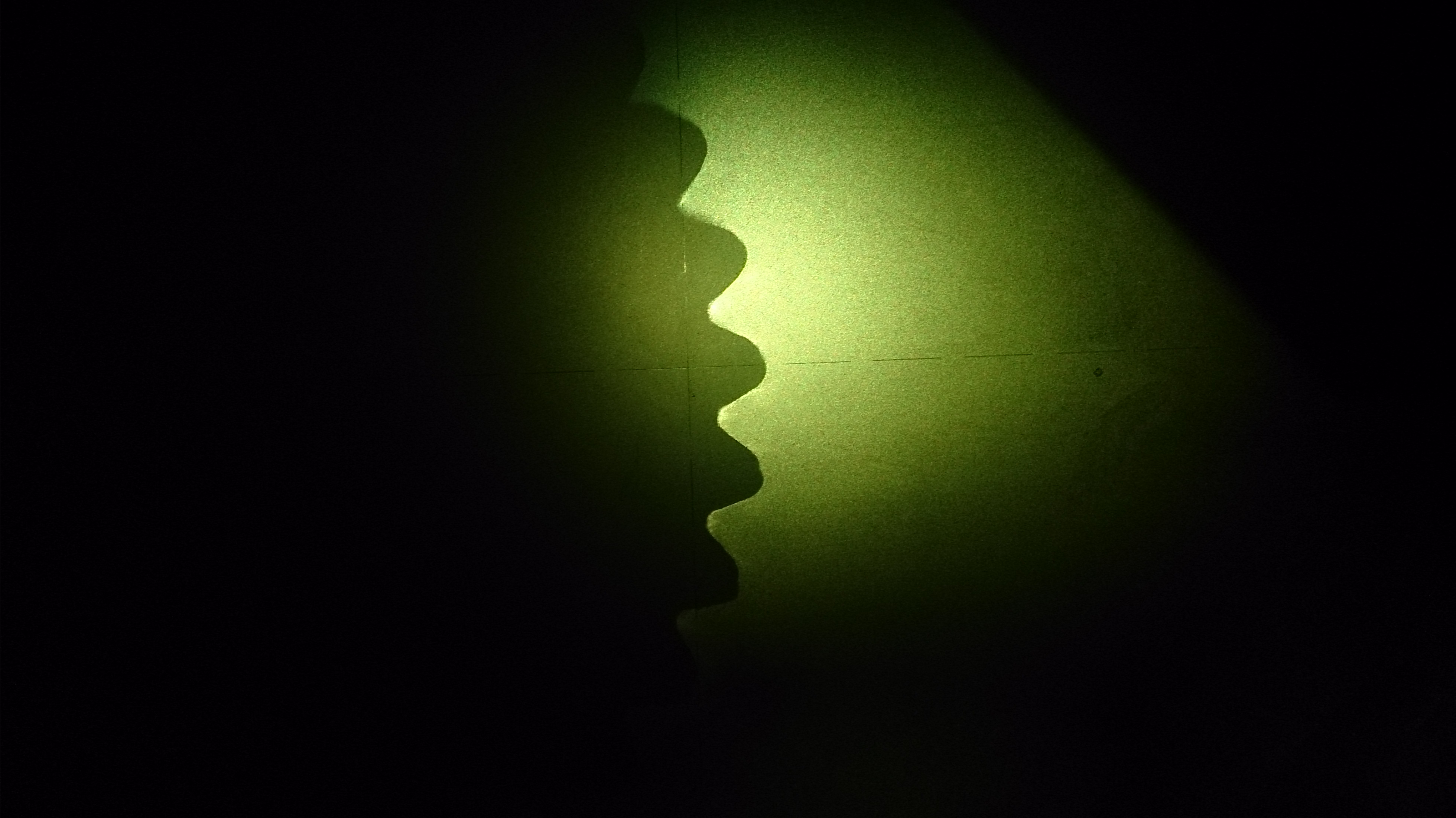

I managed to get it to show up on the shadowgraph (which surprised me as I don't know how the light managed to get past the big lump of metal attached to the shaft!) Bear in mind that the shadowgraph image may not be 100% accurate and this is a photo of a suspect shadowgraph!
There are 32 teeth and the OD is about 16.45mm but could be a worn 16.5mm. When I measured the tooth height on the shadowgraph I got 0.75mm.
I am assuming it is metric not imperial sizing as that's what the Japanese would have worked in.
I need to work out how to draw this in a 2D format like .DXF that I can then use to wire EDM the spline. The wire is 0.25mm diameter with a 0.1mm spark gap which means I can't make anything with curvature less than that of a 0.175mm rad.
If anyone can identify this spline it would be a big help...
The second question is can Gearotic generate this spline? If not any ideas?
I have a Grasshopper plugin for Rhino that can generate gears so I'm looking into whether this can generate the spline too.

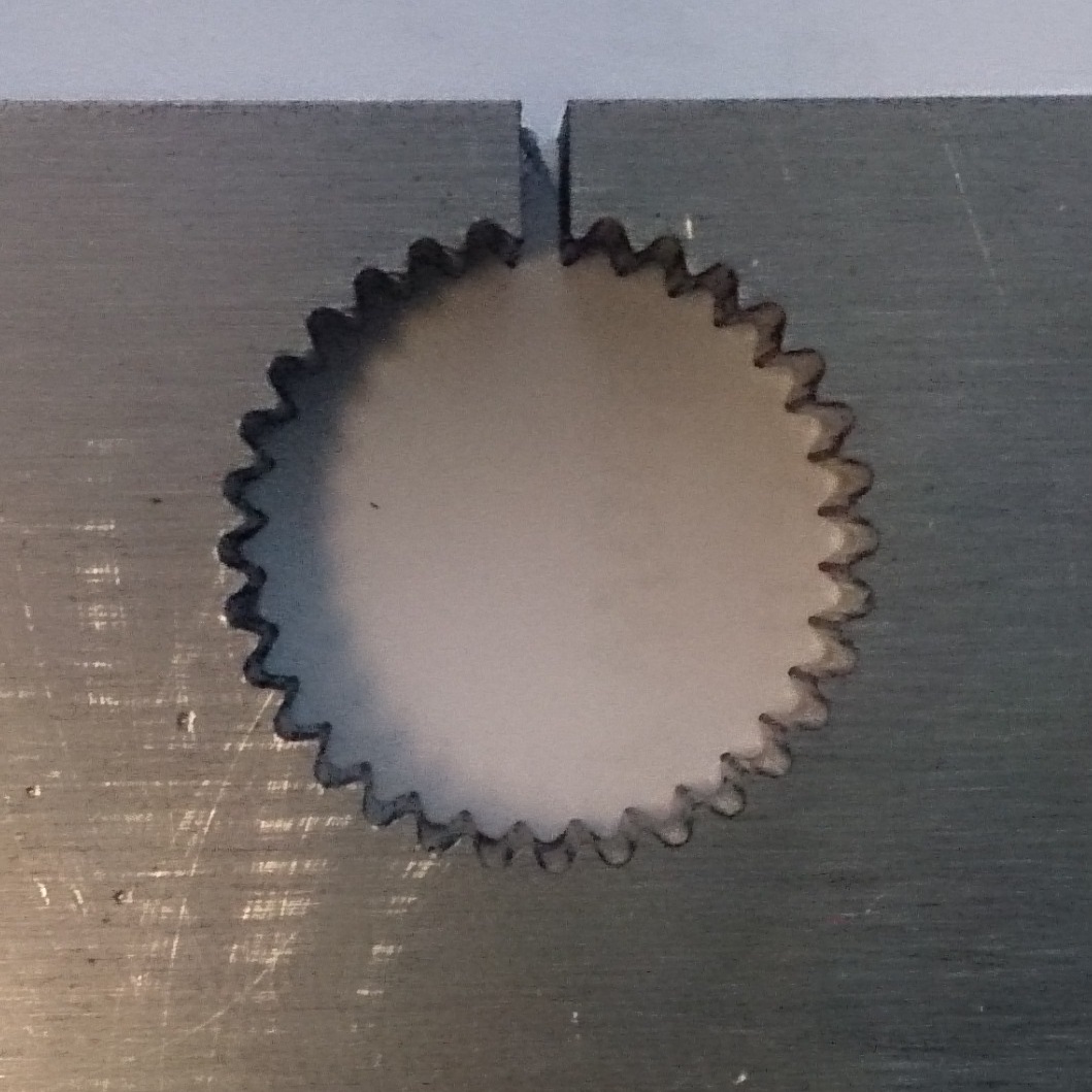

Ended up having to add an 0.05mm offset for it to fit but it fits OK!
Re: Help Identify this spline please?
Martyn:
Glad to hear it worked out. Looks like a nice fit too. Congratz..
