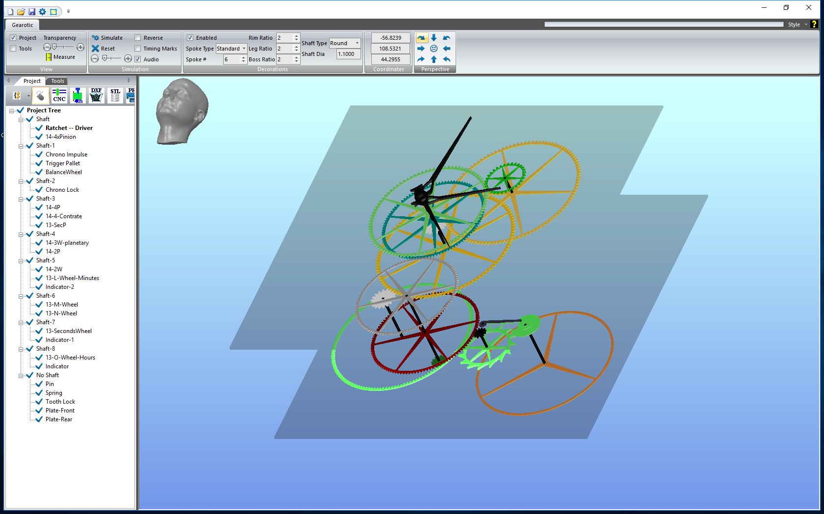

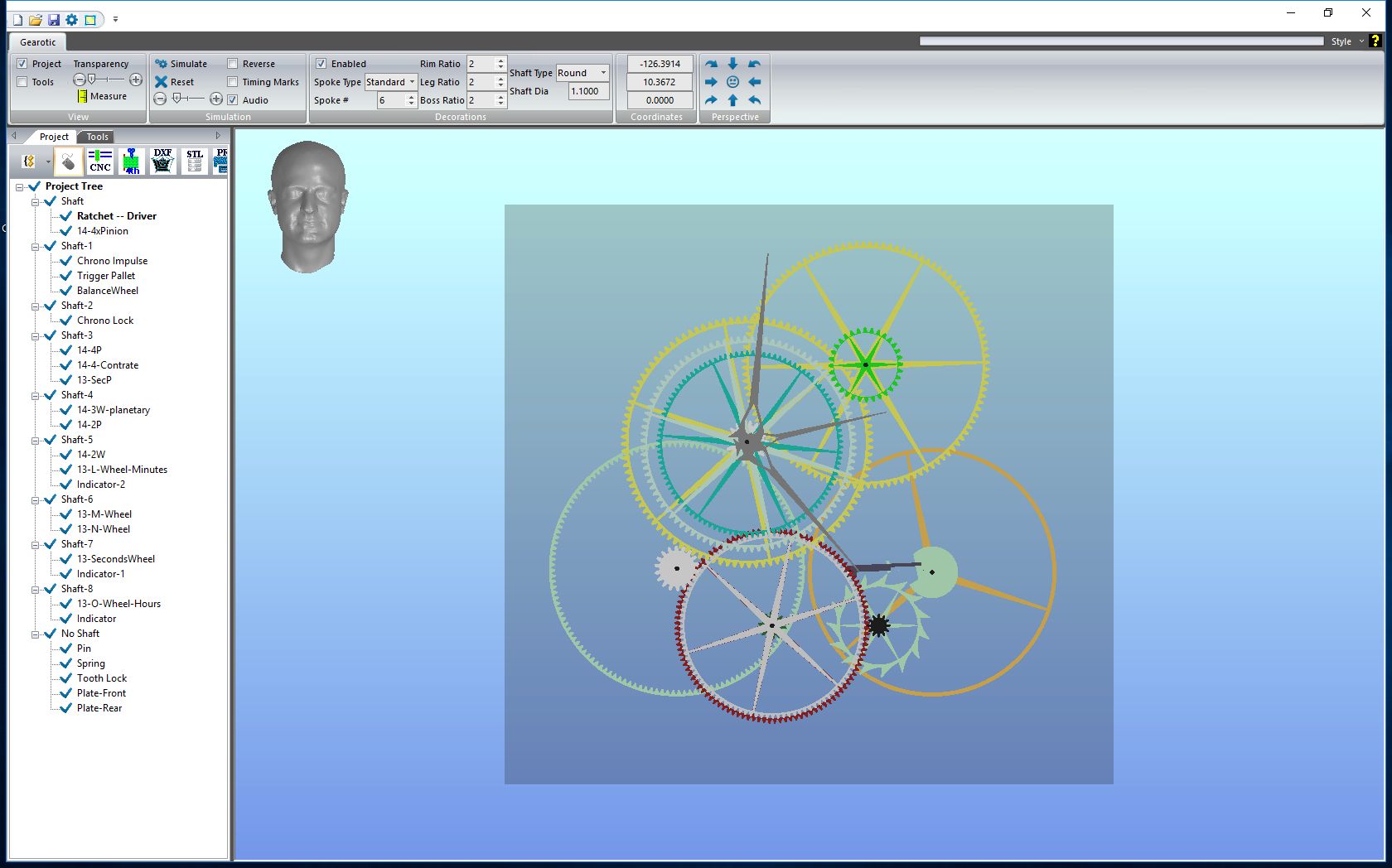

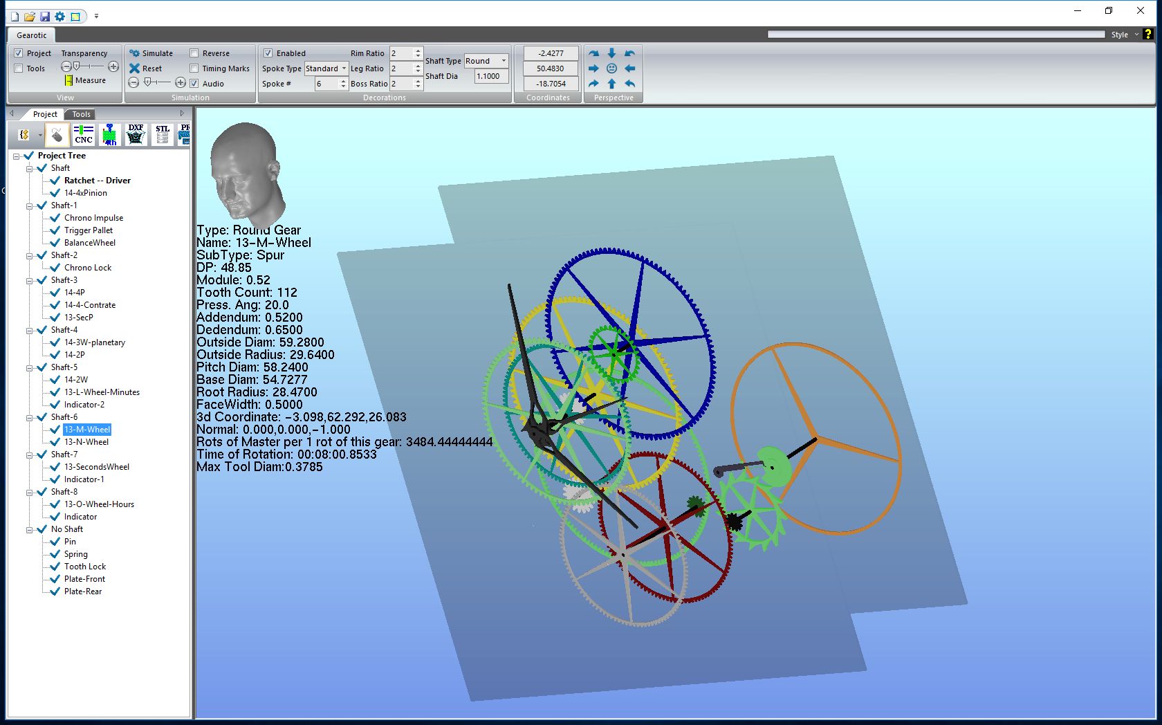

Attached are some screen captures of my Try-6 attempt to model an existing chronometer. The escapement is one of your standard ones. The real one uses a 15-tooth crown wheel that would be at right angle to the "contrate" wheel.
I don't have much time tonight to add much more description. I used XNVIEW to perform the screen captures because the Snapshot and REC do not work properly on either of my Windows10 systems.
If I have time, I can try to take a video of the model later this week using my digital camera.
Bill

I've started over on the chronometer simulation...now the gth file is >20Mbyte. I've tried Kirk's idea of doing a zip file but even that is >7Mbyte. I do have a tool under Glary Utilities that can spit files in to more manageable sizes...it can also create an addtional .exe file that would allow the file to be recombined.
Attached is a text file summary of the model that I now call ChronoSim-1.
If you are interested in trying to recombine a zipped version of the ChronoSim-1.gth file let me know and I'll give it a try.
Bill
Bill
