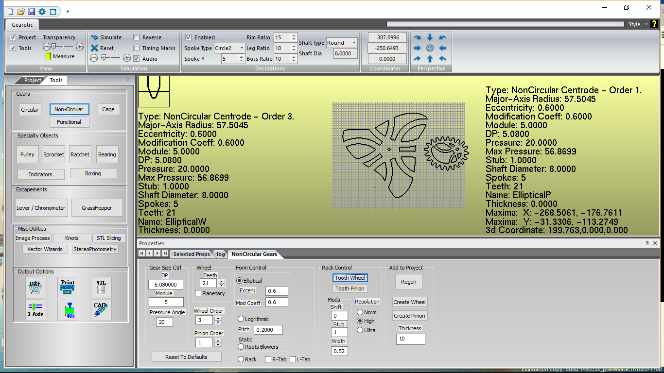

Well, that was weird.  I wanted to play along with the latest video and tried to create an eccentric gear for an example.  When I click Tooth Wheel the teeth appear, then about a second later disappear.  I tried changing the number of teeth and the mod, still does it.  The settings are pretty random, just what was left over from last time.  A screenshot is attached.

I'm also missing all text in the Job section, so another screenshot.
This is a laptop, 1366x768, i5-5200U with embedded graphics and the latest Intel driver on W10 64b Insider Preview 14955.

Re: Version 3.01
  Try a standard spoke, Im interested if the new spoking is screwing the teeth..
Re: Version 3.01
  Thx, Im seeing the bug now.. Im searching for why..
Re: Version 3.01
  I think Ive found it, a new version 3.011 is uploading as a test.

Re: Version 3.01
It's circle2 spokes, one of the standard ones.  I haven't graduated from the school of fancy spoking yet.
Guess I'm just good at breaking things.
Posts: 532
Re: Version 3.01
The eccentric gear example works!
