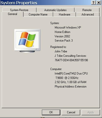

I don't know if this is any help to you, but I have a partition on my Mac that is accessed by Parallels and runs Windows XP. I have installed the latest dev version without any problem. There are some peculiarities but the design portion works fine.
If I get system info this is what it says.
