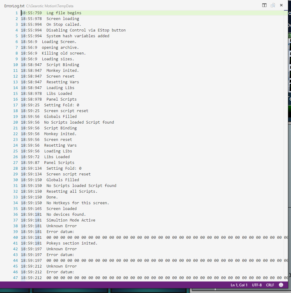

I'm getting some strange behavior when I open the new version (1.45). Installs as usual, but when I start it, it hangs after the sliding splash screen. Auggie icon is in the task bar. Auggie gui doesn't load. If you ckick on the Auggie Icon in the taskbar, the Auggie Gui appears(after a delay), but the components are all scrambled about. If you change screens(default for example), that loads fine,and if you switch back to the Pockeys screen, that works fine (and seems to work fine in simulation). I opened the log file, but seems to be some sort of infinite loop thing, as the log file crashes my text editor. Couldn't copy and paste from the editor,as it was hanging, so took following screenshot of the file. Happen all over again, on each Auggie startup. I tried rolling back one version, and it still happened ???

Re: getting the 57cnc to work with G540
Maynard:
Sorry about that, I probably hosed the simulator, Ill check it right way and let you know..
it looks like your going into simulation and its crashing it or looping it.
(I take it this IS without a Pokeys? )
Maynard:
Just uploaded a version with the simulator incapable of generating that error.
Give it another shot. If it fails, try removing your script folder just in case,
Ive tested the one I released on 2 machines with no pokeys and both worked fine,
I'm suspecting maybe I changed something in the script interface perhaps..
I was in simulation, but also hung with Pokeys, but with slightly different behavior.
Tried new version, but same results.
Removed script directory and loads fine. Jogs a stepper connected with Pokeys using the PokeysMotion screen. I have a bunch of custom scripts. Perhaps you've changed some API's along the way. I haven't updated Auggie for a few weeks, so it could go back a bit.
