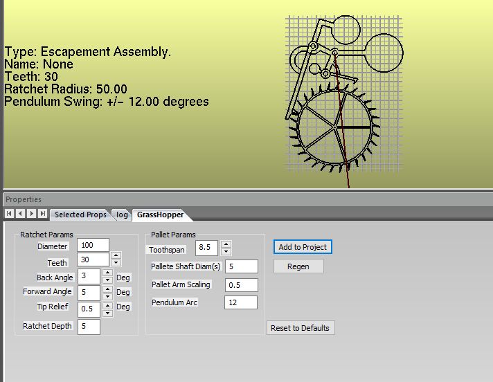

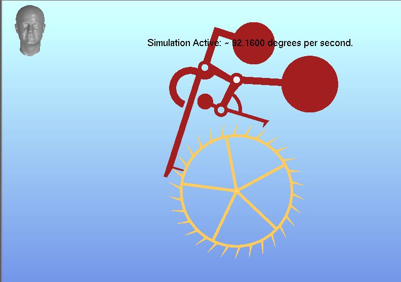

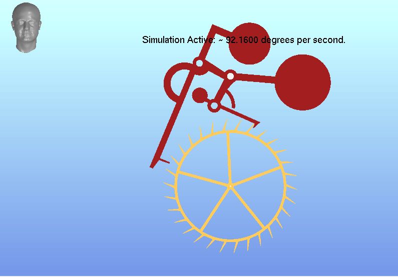

I tried creating a default grasshopper escapement. I've tested it on a Windows10 system, Gearotics2.3015
I did not experience the problem you noted. Both pallets appear to stop on escape wheel teeth and the simulation runs smoothly.
The attached jpg's show the Default Grasshopper specs, and the other two managed to catch the left and right pallets engaged with the appropriate teeth of the escape wheel.
Bill
