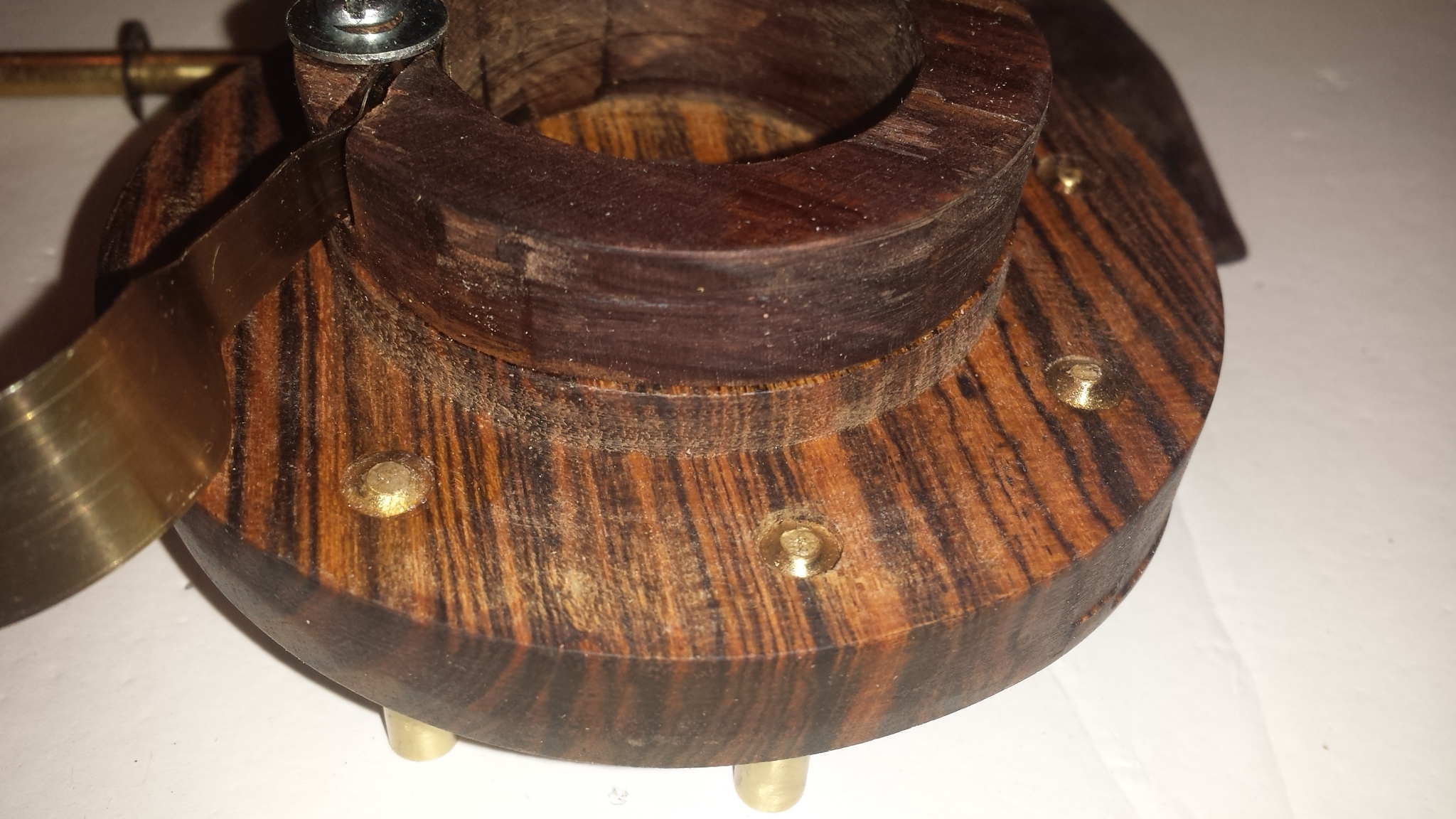

Re: Orange Clockwork Ticker
In the photo below that you named spool.jpg.
Is that 3 pieces of wood glued together?
Richard
Richard
Hi Richard:
YEs, I refer to top as the front rotating panel, and bottom as the rear. The spool is actually 2 pieces. The main spool has a ring
machined into it, and a second ring was pocketed to fit into the main spools ring, together they make the takeup spool 3/4"
thick to hold the spring as it winds on. That way I didnt have to glue on the second half of the ring, I justr pushed it into the machined
ring and glued it..
ring and glued it..
What is the length of the eight brass pins?
Richard
Richard
Richard:
They extend to 3/4 inch out of the spool, and press through to the other side
of it flush
of it flush
