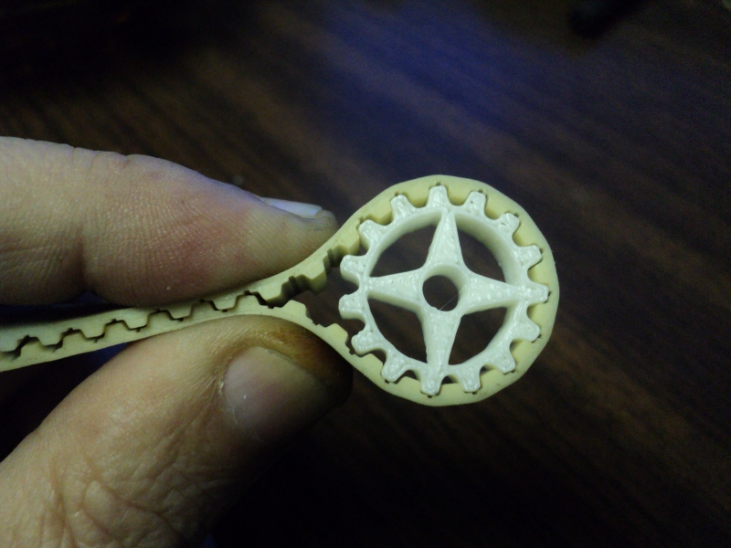

Hi Guys..
One more. A T5 pulley made to see if I could match a belt laying about in my shop.
This took 9 minutes, was printed on low res, fast mode, and seems to fit fine. As you can see its pretty
damn small..

Sure look great, if time permits one will be setting on my desk.
Thanks for posting the sample prints.
Posts: 4652
Re: T5 pulley
Hi Ken:
  Ive found the timing pulleys are the hardest to do accurately, the T5 seems to work great, the HTD3 however wont run in properly, but with a very small 3mm tooth profile it doesnt have to be out much not to work. I am going to try shrinking the print slightly as I can see the teeth are very slightly too large, after 8 teeth or so the belt begins to rise out of the mesh.. a sign of a small error..
Ill let you know how the HTD's work out, but Im pretty happy with the T5's..
